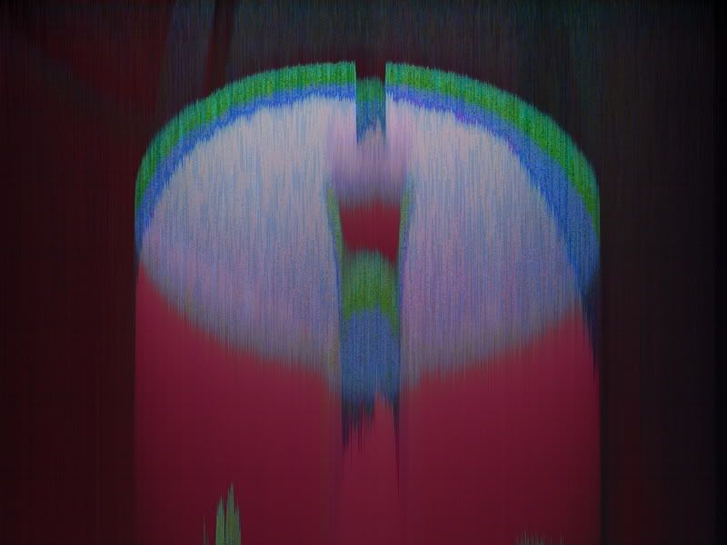

    i have a Sony Cybershot digital camera, 5 megapixels, 10x precision digital zoom. i'm don't know what the model number is . i have no idea what the problem is, i brought it to my cabin and it worked completely fine the whole time i was there, then when i got home it looked like this
    when i'm just looking around with the camera, it's all red, but when i take the pic, it turns all green like the above pic. can someone help me out with this please? your help is GREATLY appreciated.

    Sounds like it might be the well known problem with the sensor.
    Sony will replace/repair the camera if it is.
    It has recently come to our attention that a limited number of Sony products that incorporate an image sensor device, or CCD, manufactured from October 2002 through March 2004 may exhibit the following condition:
    When the product is used in camera mode, the LCD panel and/or electronic viewfinder exhibits either a distorted image or no image.
    We have determined that this condition only occurs to a limited number of units, but may be accelerated if the units are exposed to high temperature and humidity environment.
    In our efforts to ensure customer satisfaction, Sony will offer free out of warranty repair to the owners of applicable products exhibiting the above-mentioned condition.
    Find the make of your camera and see if its on this list.
    Digital Still Cameras
    DSC-F717; DSC-P10/S; DSC-P2/S; DSC-P31; DSC-P31M; DSC-P32; DSC-P32M; DSC-P51; DSC-P51M; DSC-P52; DSC-P52 M; DSC-P7; DSC-P71; DSC-P71M; DSC-P72; DSC-P72M; DSC-P8/L; DSC-P8/R; DSC-P8/S; DSC-P92; DSC-P92M; DSC-U10/S; DSC-U20/B; DSC-U20/LJ; DSC-U20/S; DSC-U30/H; DSC-U30/LJ; DSC-U30/S; DSC-U60; DSC-V1; MVC-CD250; MVC-CD250 M; MVC-CD400; MVC-CD500; MVC-FD100; MVC-FD100 M; MVC-FD200; and MVC-FD200 M.
    Typical picture of the sensor problem.

    thank you
    that pic is exactly what is happening to the camera. and it probably was in a humid environment for a while.

    sony CCD
    Sony CCD is defective in your camera.
