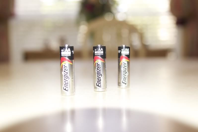

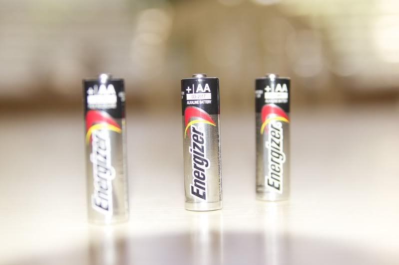

    Ok so I did this test with my Tamron 28-75 f/2.8
    Camera set to "M", ISO: 400, Aperature f/2.8, Shutter 1/125th, On Tripod.
    First is at 28mm
    Second is at 50mm
    Third is at 75mm
    9,520
    Thumbs up Acceptable result
    This is an "acceptable" result ... go forth and capture your world.

    Sweet!
    What would make it better?
    9,520
    Perhaps going to 1/160 sec, for a little more contrast. It is slightly over exposed. Alternatively, since this is a flash shot ... you can use the camera flash exposure setting to drop it a notch or two. It's a little too bright. TTL has some limitations and you sometimes need to "monkey around" with it. The camera, I believe, will provide you with +/- 3 stops of flash control. Try it out. Go from one extreme to the other to see the effect.
    Also, overall, be cognizant of having a "level" horizon. The table top is slightly skewed and since this is a tripod shot, you may want to be sure your first shot is level ... the others will follow suit.
