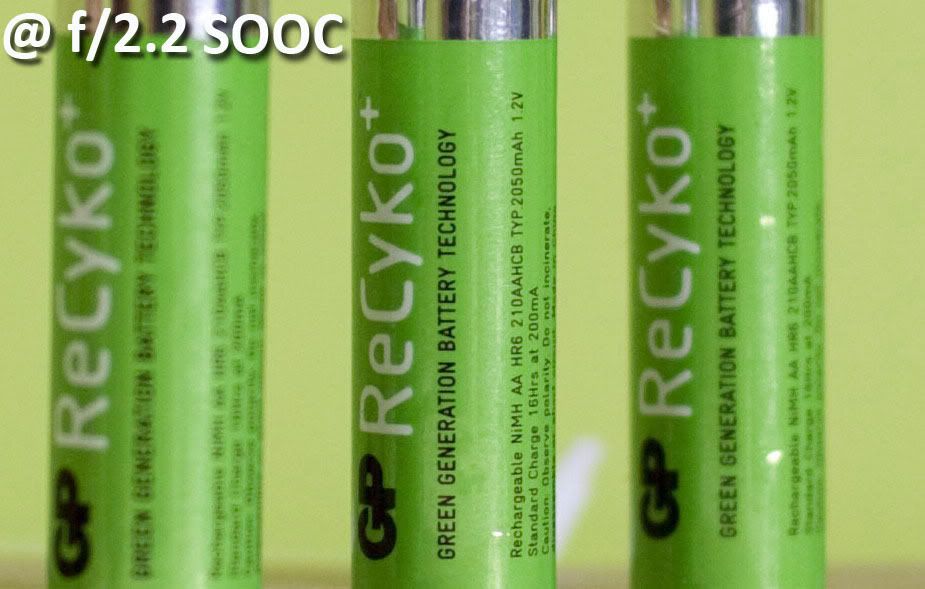

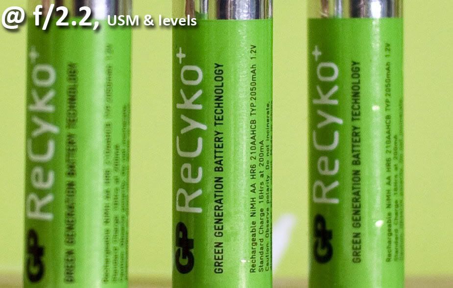

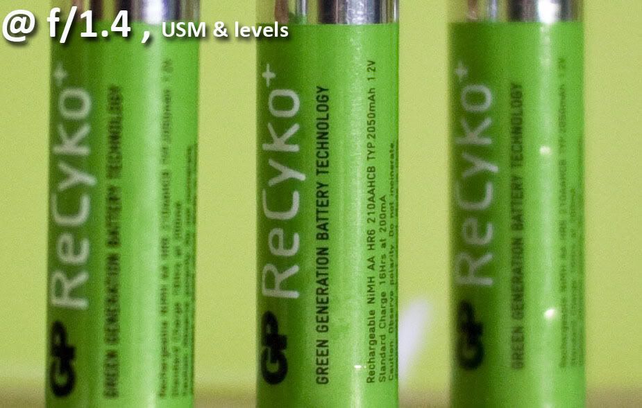

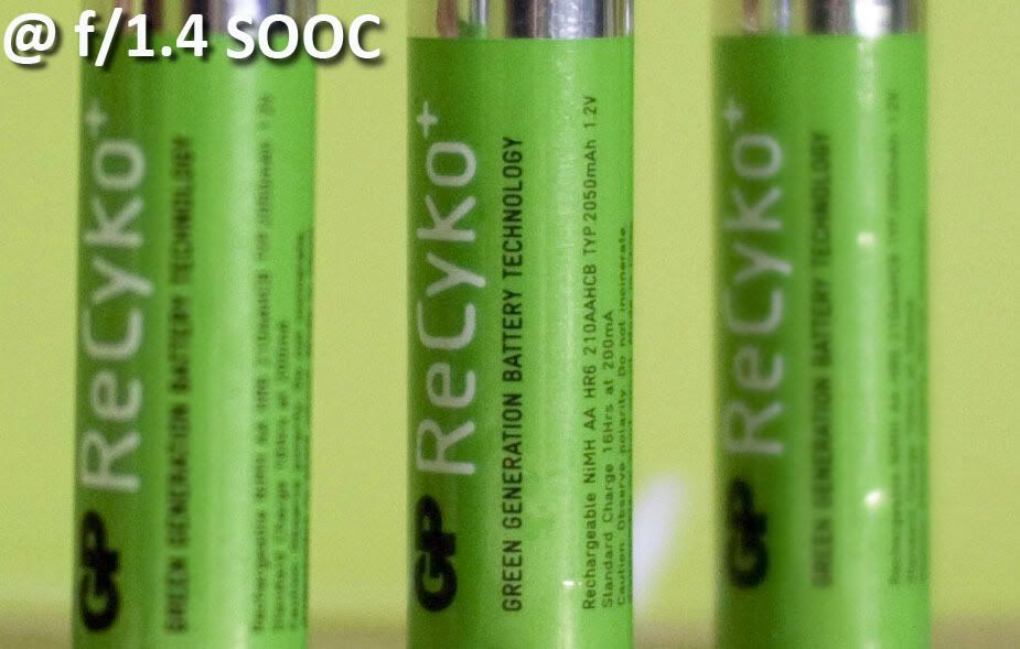

    I had read numerous tales of front / back focus issues with these large aperture Sigma lenses ( 30mm 1.4 & 50mm 1.4) So, i immediately put her to the focus test!
    The test subject were three AA batteries placed diagonally 10mm across and 10mm behind. The Camera was placed on a tripod 600mm from the center battery which was the point of focus.
    I focused with the 'center focus point' in the 'One Shot' AF mode.
    Here's a setup diagram for the focus test shots..
    Here's the test results. All 100% crops:
    So, what do you guys think?

    Looks like a mild back focus at f/2.2 but that could just be the focusing angle.
    From what I've read and understood so far, its an inherent property of such large aperture lenses to have the focus plane shift backwards as you stop down the lens...
    As of now, I'm mostly using this between 1.4 and 2.0
