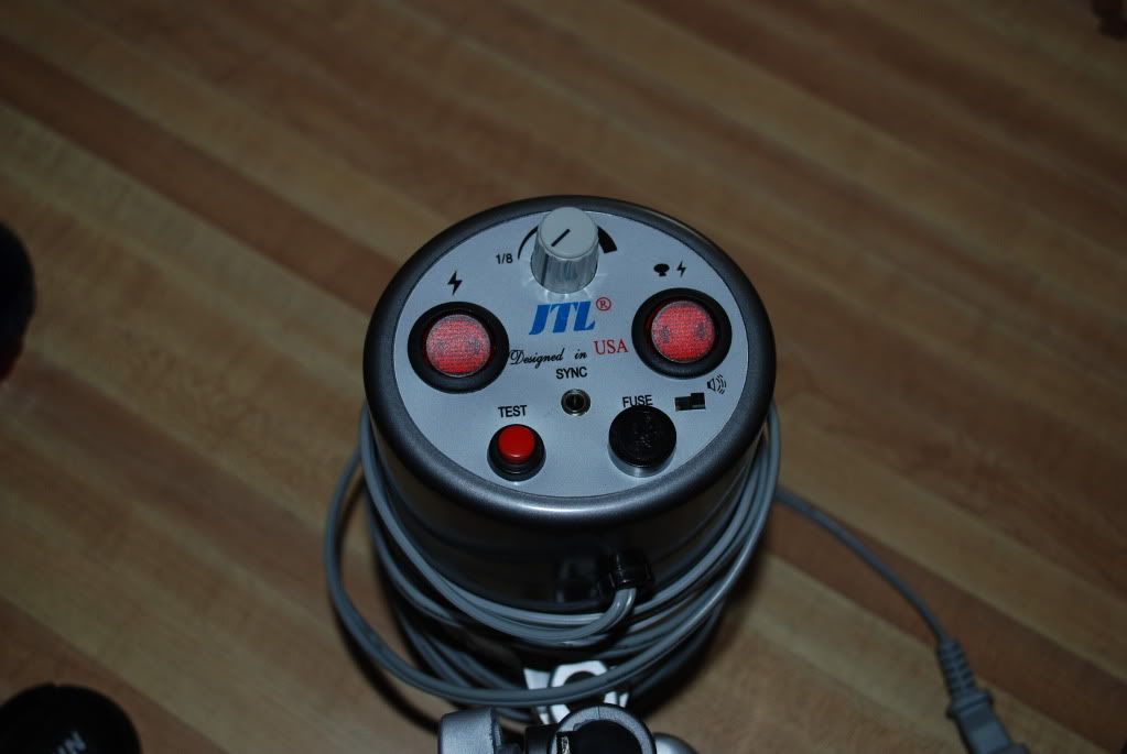

    This is what I want to sync.
    It has a 3.5mm plug I think.
    If I wanted to use these strobes with my SB 800 & SB600, would I need recievers for my speed lights also?
    If I wanted to use these strobes with my SB 800 & SB600, would I need receivers for my speed lights also?
    Each light requires its own receiver.
    the 3.5mm jack cable that you need to attach to that light in your picture is provided in the box.
    Your SB-800 already has a sync port so you simply plug the 3.5mm to pc sync cable (which is also provided in the box)
    Your SB-600 doesn't have a sync port so you'll need to buy the hotshoe adapter I linked to in my first post. The adapter has the proper 3.5mm jack to plug directly into the receiver.
