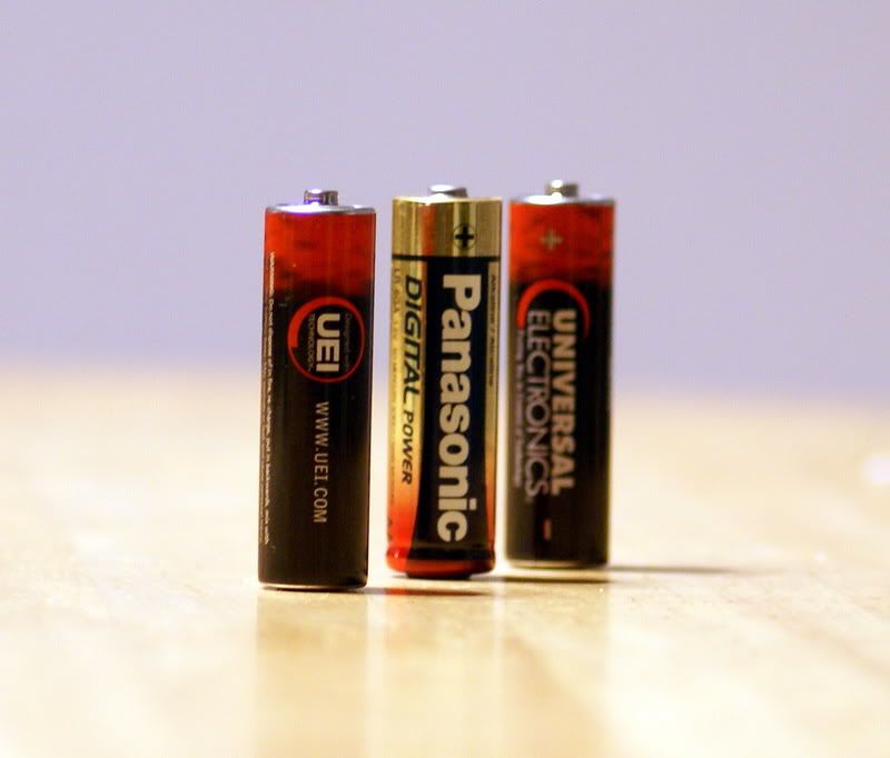

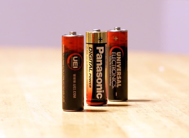

    I tried the back focus test on two of my lenses. I don't know if I did it right. What do you think??
    Thanks Frank
    Minolta 50mm
    Camera Make: SONY
    Camera Model: DSLR-A100
    Image Date: 2008:12:27 23:51:12
    Flash Used: No
    Focal Length: 100.0mm (35mm equivalent: 150mm)
    Exposure Time: 0.200 s (1/5)
    Aperture: f/4.0
    ISO equiv: 400
    White Balance: Auto
    Metering Mode: Spot
    Tamron 70-300
    Camera Make: SONY
    Image Date: 2008:12:27 23:48:31
    Flash Used: No
    Focal Length: 50.0mm (35mm equivalent: 75mm)
    Aperture: f/4.0
    ISO equiv: 400
    White Balance: Auto
    Metering Mode: Spot

    Cool Into your positions ...
    Frank ... they look a little close ... spread them about an inch apart, horizontal ... and an inch and a half in between, diagonally.
    Name:  bat position.JPG
Size:  13.6 KBName:  28mm-afta-adj.jpg
    I though it was an inch apart. I forgot my Ginkoba.LOL I will do it again in the morning.
    You want a bit of space between each battery ... so the camera is not tricked into focusing incorrectly, but on the center battery ONLY.
    Use spot focus and your WIDEST aperture.
    I am going to make a index card so I have it made and don't have to rely on my memory.
    You might find this helpful http://focustestchart.com/chart.html Just print out the test chart and take a picture. The test was designed for Canon back focus issues but it works for any camera.
    You can see that on this test the lens is in focus from about 9mm in front to about 18mm behind. This is normal, I usually work on DOF being one third in front and two thirds behind the focus point.
    Somebody on this forum originally pointed this test out and I'd give credit if only I could remember who.
    I did test my other lenses with that test. I just wanted to do a quick test of the Minolta 50 mm.
