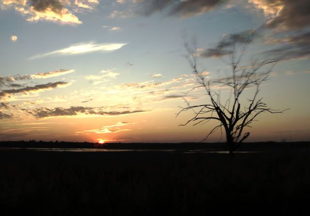

    Here we go again. I took the tripod and camera and went down to my favorite tree by the bay to attempt another HDR. This time I used 7 images. I will post a link to the images I used. The first one didn't come out good but I am posting it anyway. I am working on the next one.

    Boy do I need him. What did I do wrong? Or should I say did I do anything right. Here is the next one. I think it is better but what do I know. LOL

    I just took a quick look at your source images and they don't have enough on the over-exposed side of the equation. Therefore your foreground is still very under-exposed, nearly a silhouette.
    This is a difficult scene to expose properly, the backlighting will fool your meter into thinking the scene is much brighter than it actually is. In this kind of lighting, your base exposure will need exposure compensation to start with. Or you need to go quite a few stops to the + side and not near as many to the - side.
    In Michael Reichmann's tutorial, he says to use many exposures, I don't fully agree with this, in my limited experience 3 exposures are usually enough to get started with and learn with, 5 will render excellent results.
    Each of these exposures should use the same amount of EV. The additional exposures should be in equal increments of +1, or +2 EV. This helps the HDR program blend the exposures smoothly.
    It also looks to me like you were hand holding these shots. But now reading the OP I see you used a tripod, was the wind blowing? If it was that woudl explain the tree branches. I don't know much about Sony, but I assume you can do RAW, and your software package includes a RAW editor. If it's windy take a single RAW exposure right down the middle. Then when you process the RAW file process three files, 0, +2 and -2 EV. Then use those for your blend.
    A remote shutter release also goes a long way toward crisp shots, and in lieu of that, the timer will suffice as it give you a chance to get your hands away from the body.

    I took some of the originals without the tree and generated an HDR with them, then tone mapped, I added some luminosity to help with the foreground.
    If I were you I would start with just 3 exposures using a 0 EV, +2 EV, and -2 EV for the bracketed shots. Support your rig. Go through Don's steps, but at the end choose "local adaptation" and play with the tone curve to get the highlights, mid tones, and shadows to closer to what your eye saw.

    Thanks TenD your HDR looks good. I did use a tripod. I was trying to take the shots fast because the sun was setting fast. I should have taken off the AF and used MF. I also should have metered the foreground like you said. I forgot shooting into the sun messes with the meter. I learning a little at a time thanks to everybody here.

    I don't know how your Sony handles auto exposure bracketing, or if it even has it. When I use the timer combined with AEB at the end of the timer the camera will shoot all three exposures rapid fire, as fast as the shutter speed and body limitations will allow.
    If your camera doesn't have this function, then a remote release becomes a necessary piece of equipment. I won't take an early morning or late evening shot without one.
    Scout your locations early, take some photos, see what works. Then go back with about an hour before sunset, set up check your settings, re check your settings, watch the light. Snap off some sets of 3 or 5 when things look good to you. Be totally ready when it comes time to trip the shutter. Great photos are rarely "grabs" usually a lot of planning, a lot of visits to a location, and deliberate actions get the shot.

    Here's a wack at the other set:
    Ended up with some weird artifacts along the trunk of the tree.

    In both of those attempts the foreground is a little too bright, but basically it's an illustration of what can be accomplished. With more careful processing and some burning and dodging of the blended photo, quite a nice photo can be produced.
