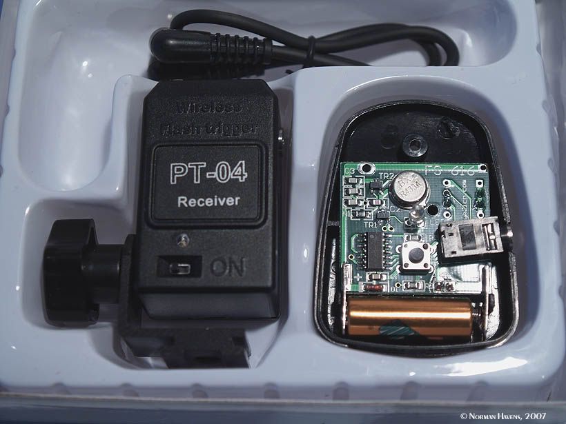

    The transmitter battery is a Chinese-made Vinnic Alkaline L1028 23A (12v), apparently only rarely found in the West, mostly in such devices as auto burglar alarms, key locks, and garage-door openers. Searching the Web I discovered that an equivalent is available in the Panasonic LR-V08, so I’m relieved that it won’t be hard to find replacement batteries..

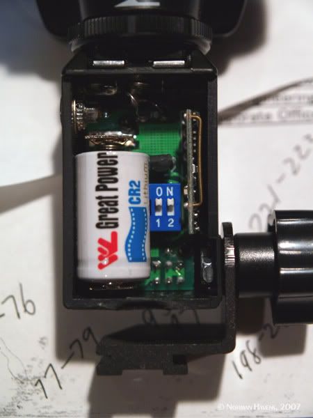

    As I noted, the receiver uses a standard CR2 Lithium battery, which was included separately. To load that battery, you pry open the compartment lid on the back of the receiver. Also inside the receiver case, visible in the photograph, are the two tiny DIP toggles to set the channel on the receiver side. Corresponding DIP switches are located on the underside of the transmitter; the two switches allow the channel to be changed in four possible combinations.

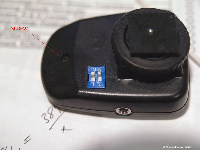

    As you can see from the photos, the innards of these things are completely exposed when the covers are off, and almost no insulation is placed between parts, so be very careful not to poke around and touch something with a screwdriver that might cause a short. Also note the bolt head for the aluminum mounting bracket on the right side; it’s very close to some electrical circuits, so take care when loosening it. Obviously there’s no water resistance in the casing. Enough said.

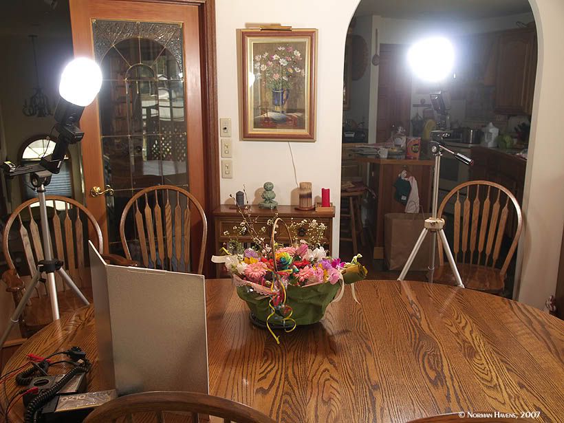

    In addition to the FL-50 on the radio trigger, I have an old Panasonic PE-381SG flash that I trigger via an optical slave. Yesterday in practice the setup worked flawlessly. I successfully synched the shutter of the E-300 up to 1/250s. At 1/320 I began to see shutter-curtain shadow on the bottom of the frame, but the flash continued to trigger normally..
    I have no large softboxes, so I put my Gary Fong Lightsphere on the FL-50 and a homemade lightsphere on the Panasonic flash. I was just practicing today to get some lighting ratios down. Here's what the setup looked like on my dining table:
